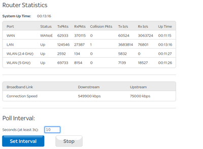

Broadband dropping upwards of 4 times a day - orange voice light
It seems to be a common problem with the sky boxes, but hoping to get some help since most lead to nothing or sky employees going into private chats.
Here are some details I can provide:
500Mbps plan
FTTP
kernel [52703.652000] pgd = e0698000
kernel [52703.652000] [ffffffe8] *pgd=2f7fd821, *pte=[number which forum didn't allow], *ppte=
kernel [52703.653000] Process skytelemetry (pid: 22128, stack limit = 0xdcc5e190)
kernel [52703.653000] Stack: (0xdcc5fd00 to 0xdcc60000)
Apr 13 18:02:14 skyhub.ihr tr69c TR69: Connect to Production ACS
Apr 13 18:02:14 skyhub.ihr tr69c TR69: Connection to ACS Complete
Apr 13 18:02:21 skyhub.ihr tr69c TR69: Close ACS Connection
Apr 13 18:02:22 skyhub.ihr voice Voice Configured
Apr 13 18:02:25 skyhub.ihr voice Voice Initialized
Apr 13 18:02:25 skyhub.ihr voice Voice Connecting
Apr 13 18:02:26 skyhub.ihr voice Voice HARDENING
Apr 13 18:02:26 skyhub.ihr voice Voice Connected
Apr 13 18:02:26 skyhub.ihr voice Voice Disconnected
Apr 13 18:02:31 skyhub.ihr voice Voice DeInitialized
Apr 13 18:02:34 skyhub.ihr voice Voice Configured
Apr 13 18:02:37 skyhub.ihr voice Voice Initialized
Apr 13 18:02:37 skyhub.ihr voice Voice Connecting
Apr 13 18:02:38 skyhub.ihr voice Voice Connected
