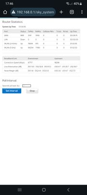

@Mark310 Could you please post your router stats following the link below.
Message posted on 09 Aug 2024 05:48 PM
Re: Broadband dropping constantly for last 24 hours.
Router Statistics System Up Time: 01:05:25 Port Status TxPkts RxPkts Collision Pkts Tx b/s Rx b/s Up Time WAN Down 0 0 0 10429 0 00:00:00 LAN Down 0 0 0 0 0 00:00:00 WLAN (2.4 GHz) Up 15966 915 0 10787 0 01:03:25 WLAN (5 GHz) Up 95927 72717 0 341285 50048 01:03:22 Broadband Link Downstream Upstream Connection Speed (Kbps) 0 0 Line Attenuation (dB) 0 0 Noise Margin (dB) 0 0 Poll Interval: Seconds (at least 3s): 10 Set Interval Stop
Hope this proves useful.

Message posted on 09 Aug 2024 06:20 PM
@Mark310 Can you please run the broadband test, this can be done either via the Sky app on mobile data or use the link below.
https://www.sky.com/help/diagnostics/sky-broadband-diagnostic/sky-broadband-diagnostic
If it finds an external fault it should enable you to book an engineer.
After the service checker completes and if it comes back green all good can you click on broadband to run an updated test please. If you get amber or red please follow the on screen instructions.
