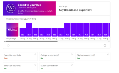

For the last week my broadband download speed as been half the speed as normal, down from 74Mb/s to ~ 38Mb/s and then this morning the connection keeps dropping and reconnecting. My Sky broadband checker reports all green although speed to hub is "poor". No way for me to book an engineer to visit or any further details to contact Sky.

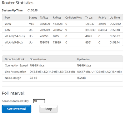

These are my router stats:-

At the time you posted there was no fault but if you say it goes from 70Mbps to 38Mbps then that wouldn't be unheard of
