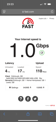

it is possible to get the max speed of the package using WiFi but you need to have compatible equipment and different speed tests will give different results
the iPhone 12 and 13 had a known issue where they supplied hardware that was limited to 550Mbps
