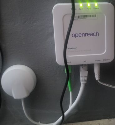

Question  do you  have full fibre to the property  broadband and one of these  in your  house as I  have  gigafast  and it changed  from 500mps  to  to 900mbps  within an hour, this is the  optical network terminal box that the router  connects to
