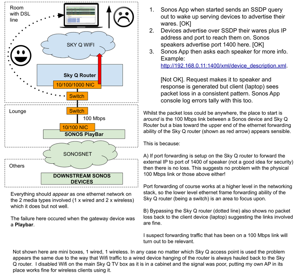

The underlying issue with Sky Q provided Wifi is less to do with how the mesh network works between all Sky Q equipment. That often works fine whether they're connected wired or wirelessly.
In either case think of that network as the backhaul network of the Sky Q system.
Usually when deciding to provide WiFi from a backhaul network one would imagine that the network in the access point device regardless of it's uplink type would simply be bridged/repeated and made available. In this sense an entire LAN would be one layer 2 network.
This is not what is done by Sky Q. Instead the Wifi provided by Sky Q acts more like what would be a called a guest network (It's probably like a tagged VLAN or something under the hood). That guest network is serviced via the Sky Q router. This is why it is said one can't use Sky Q TV boxes as Wifi access points unless your broadband is provided by Sky because they explicitly don't just bridge the network they're uplinked to themselves but rely on services of the Sky Q router. This will have been done so that traffic for video streams can be prioritized most likely, so the client device Wifi provision is secondary in some respects.
Conversely, the ethernet ports on the back of the Sky Q router can be considered to be what would be a private network (not a tagged VLAN like what appears over Wifi). Obviously everyone having trouble with Sonos doesn't want two networks and the terms guest and private could be swapped for anything really but I've used them because the overall effect is similar to such a setup if it were wanted.
Technicaly speaking we can event think of 3 networks or pseudo VLANs, guest, private and TV.
Now the difference between the guest and private networks is not full isolation which would make them pretty useless to let wired and wireless LAN devices talk to each other over ethernet. There is some attempt to bridge them inside the Sky Q router but not a very good one. This is is a bit like trying to undo the separation that done earlier to make the TV distribution work well in many respects but undo it all out of the way inside the router so to speak. tl;dr - Sky Q provided Wifi is much more complicated than one might think and will throw some knowledge of networking out the window and confuse even very knowledgeable engineers.
One can easilly test bridging ability between the two networks easilly enough. Obviously ARP works fine, allowing the same IP subnet accross both netwoks. You can use tools like fing from a device on one network and see devices on the other.
Several other protocols fall down however. Things I've tested that do not work if a client is on one network whilst a service is on the other.

One thing I forgot to say was that at least for Sonos specically the bug in the Sky Q router only affects functionality in a particular direction.
The table feature of this forum does not work so here's it shown as a table with a key:
| | CR | CW |
| SR | OK | FAIL |
| SW | OK | OK |
CR = Client device on wired Sky Q router port
(includes case where device is on one's own Wifi AP that is plugged into Sky Q router)
CW = Client Device on Sky Q Wifi
SR =Sonos on wired Sky Q router Port
(includes case where Sonos is on one's own Wifi AP that is plugged into Sky Q router)
SW = Sonos connected via Sky Q Wifi
(normally without Sonosnet or plugged in point-to-point into a TV box making it be on Sky Q Wifi that way)
That is to say discovery attemps (I can't say packets) from clients on Sky Q Wifi to Sonos devices connected via the wired router ports get unfullfilled but do work the other way around if the client is connected via the Sky Q router port and the Sonos connects via Sky Q Wifi. Of course it might actually be that either the requests or replies are getting lost, so the direction when spoken of in terms of packets could be either way around.
However the segmentation is asymetric in nature at least.

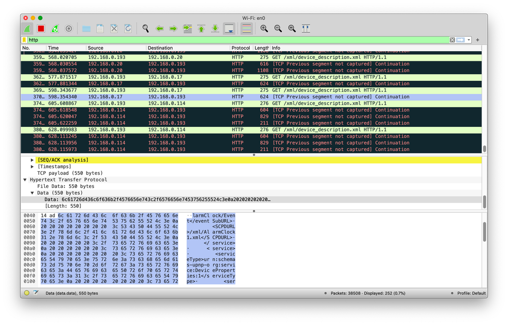

My last post appears to have gone but in a nutshell Sky Q is mangling http connections that originate from client devices on Sky Q Wifi to Sonos devices connected via the wired router port.
Given a url like below (not in URL form as I think that is what blocked my prior post)
PROTOCOL: http
IP: That of any Sonos speaker on your network
PORT: 1400
PATH: /xml/device_description.xml
If you try this in a web browser it will not work when your computer is on SkyQ Wifi and the Sonos is wired. If you connect your computer to the back of the router and put the URL in a browser again then it works.
Note however that port 1400 isn't fully blocked. If you look in Wireshard you can see a partial response does come back and then it just fails from there. This was the exact same thing I saw with video stream data coming back from an Oculus Quest 2 headset.
Here is Wireshark showing what's going on whilst a copy of wget is trying to pull the description from a Sonos speaker.
So, there is something nasty about traffic where Wifi based clients try to pull data from wired services on one's network for sure here.

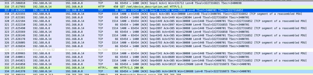

@Mad+Sweeney Tried Fast ethernet but this didn’t seem to change the situation.
This is what wireshark shows for the call and response, evaluating this is beyond my experience though.
