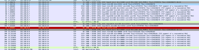

If you are still following this then, I used wireshack to capture traffic to and from Play 1 and TVBeam.  There is a slight difference in the [] parameters for the return is this significant?
The outgoing traffic to …07 (Play1). Which responds
The outgoing traffic to …08 (TVBeam).  Which doesn’t respond.
The return traffic

So it looks like the reponse from .08 (TVBeam) does appear on the wire at it is the penultimate thing shown in the shot. If you were to click on it you'd see the XML that should appear in the browser.
There is a RST - Reset coming back to a different port on your machine. So two different ports were used to talk to .08.  It is hard to say, as the first one might have been the browser and the second one the Sonos app.
Given the Sonos app is now working to control everything, it looks like there is not much more to diagnose so it may not matter too much if pulling the device xml data from a browser works or not.
Since connecting via Wifi (not plugging stuff into the Sky equipmentt) is a more normal thing to do, I think you'll be more lucky with leaving it all this way.

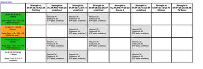

I don't know if you know this but you can also pull up a network matrix by visiting any Sonos device on port 1400 at the path /support/review.  It's quite nice as each device is shown as both a row and a column and the squares where they meet show the connection between devices.  The grey squares show that 2 devices could talk to each other but this way but choose not to and the coloured in squares show where two device do talk to each other.  It's a nice way to see that Sonosnet is all good really.  In my setup you see that there is one device there that is able to talk directly to all other speakers apart from the rears/sub of the 5.1 setup as they connect via the playbar.  In this case this device is also the one with the ethernet jack and in the centre floor which makes sense for my house.
From a techy standpoint, now you've got Sonos on Sky's Wifi, any BPDU frames Sonos should reach the Sky devices without worring about your switches.  You're in the hands of Sky to do the right thing w.r.t Sonos working but this way they have more of a fighting chance with less unknown equipment in the way.  After all now the only thing between Sonos and Sky Q is air.

I did not know that you can also pull up a network matrix by visiting any Sonos device on port 1400 at the path /support/review - and even now I'm not sure to action this.

Ok sussed out how to to the matrix thing - now to explore it a bit

I agree I have probably reached my end game.  However, I did have a poke around the matrix etc you pointed me at.  I have watched a very useful guide to this on Youtube and must say didn’t see what I expected.
So, my devices are indeed listed down the left column as expected, but each device seems to have two entries with adjacent MAC addresses, across the top of the matrix.  Crafting is ….38 but there is a….39 which seems to have the information regarding signal strength, with no indication of the route being taken (as per the info on youtube). Do you know why?  I suspect that this is because the system is on the Wifi rather than the Sonosnet and if I plugged a cable in, I would get a different result (tonight’s trial).
On all of devices the /usr/sbin/brctl showstp br0 call returns that STP is disabled for this interface - this is a puzzle to me

The picture is it not moderated yet but I can answer that last question with some preamble.
So all Sonos speakers have at least one wired port and one radio.  These are named
ethX (eth for ethernet) and athX (ath for Atheros, the wifi chip maker).  A virtual bridging device br0 is then created over these.  The ports have their own MAC addresses but the bridge presumes the MAC address of the ethernet port.   Devices with 2 radios and therefore an ath0 and ath1 are those which have an additional 5Gz radio for surround sound support.  Such a device which is not actaully setup for surrond will not show its 5Gz radio and I presume it just switched off in that case and will just show ath0.
So having 2 Mac addresses is normal.  Usually the one for the wired ethernet is what is printed on a label.  The same applies to the Sky Q kit in this regard.
So the reason STP would be disabled I presume is because by connecting over Wifi.  The sonos radios all try to talk to your access point.  Presuming that they all can do so and  if you drew this out as a diragram you can see there is no way this could (or should be able to) create loops, so STP would be a waste of time.  If you had more than one AP with the same SSID then loops would again become possible if some devices were on one AP whilst the others were on another (sound familar?)
As soon as you plug a cable in, the Sonos will thing to itself, well that cable could be plugged in anywhere including media that bridges to devices already accessable via radio.  It would likely start running STP if you did that.
I did some other reading and I think Sonos is super smart and if for example you put a speaker out of reach of the Wifi access point, it would give up on talking to your access point and try to find a nearby Sonos speaker (or Boost) instead.  In this case it would be running in a sort of hybrid mode.  It might switch STP back on in this case too if perhaps it can flip between the sonos net and wifi if both signals are present but Sonosnet looks better.

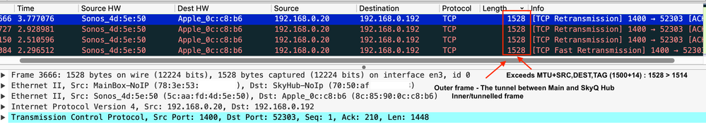

This message was authored by: Mad+Sweeney Answer
Re: SkyQ and Sonos interfering with each other
I've proven some of the stuff I suspected was happening here actually is - tl;dr -
  • Scenario is quite obscure - depends on topology.
  • Sonos can drop data but Sky Q is passing data that standards would dictate that Sonos should drop.
  • Other 100Mbps equipment like Sonos might do the same thing.
  • Have not tested what happens if Sonos is made to bridge traffic between Sky Q boxes wirelessy. This might happen by accident in a mesh.
-- more detail --
It is a reasonably obscure scenario to get into either by wriring up a particular topology in your home, or perhaps if certain links are made to be up or down in the overall mesh of the two systems.
The problem occurs if a piece of Sonos equipment (perhaps any 100Mbps equipment) is used as a bridge to forward ethernet frames that use Sky's tunnelling protocol and that these frames are too big for Sonos to forward.  What is in these frames un-tunnelled can ironicaly be the Sonos traffic that could have previously passed through that Sonos device before in the opposite direction.  My broken topology did put this constraint on a Sonos device (a Playbar in this case).
So the Sonos is at fault? No.
In this case the Sky Main box is sending a frame to the Sky Hub (I think the laptop up there moved onto the Hub's Wifi AP different from my pictre above) that has a size of 1528.
This was gotten from Wireshark monitoring a mirrored switch port and setting the network interface in Mac OS to allow jumbo frames.  Otherwise my computer itself would sillently have dropped these frames and I could not have shown them here 😃. Also to show the tunnelling you must add this configuration to Wireshark.
decode_as_entry: ethertype,29812,(none),Ethernet
decode_as_entry: ethertype,29920,(none),Ethernet
The maximum size that should appear to be more compliant is 1514.  That is the MTU of 1500 and the 14 bytes that make up 2 x 6 byte MAC addresses and the 2 byte protocol.
So the Sky tunneling protocol is broken as it can not tunnel through devices that limit their frame size in a more standard way, and may be limited from allowing anything more by their hardware too.
If the inner frame were 14 bytes or more smaller then it would make it through, so pings and smaller TCP streams will make it through.
A a fix in this lab test like topology would be for the MTU as seen by the OS inside Sonos to be lowered by 14 bytes.  This would make the tunnelled Sky Q frames smaller because the original Sonos frames before tunnelling would be smaller.  It would only help Sonos traffic and not other traffic that got tunnelled.  It would be a silly thing for Sonos to do really anyway.
What Sky will have done with their protocol is have been sneaky and tried to take advantage of the fact that newer equipment supports larger ethernet frame sizes in order to  support things linke 802.1ax which gives an extra 22 bytes to play with, though these are supposed to be in the headers and not in the protocol data unit.
