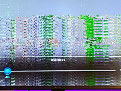

Message posted on 02 Dec 2021 06:21 PM
Re: SkyQ Download Failed Item Unavailable
So when I do manage to download something this is what I get ..., what a joke!
Message posted on 02 Dec 2021 07:26 PM
@Faithylu - exactly same here, corrupted when it does actually work. Also on BT. I did change the download format to SD and that helped for a bit, but now nothing is downloading.
