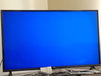

I've got an issue here which has been the case since about 8pm on Saturday night. At that stage I started getting the "No Satellite Signal" message, and I'll stress that's not the first time I've had that in the past 18 months. I did what was suggested on here and reset it at the mains, only for it to keep appearing. Eventually it began flashing intermittently between "No Satellite Signal" and "Technical Fault", so I tried again with the mains reset. This time I left it off overnight until Sunday morning. When it came up with the same messages again I attempted a Factory Reset (the second time I've had to do that in 4 months, and it fixed it on that occasion), and since then it's been coming up with just a blank blue screen meaning I can't set it up again, and the Satellite Signal message still appears after about 5 minutes or so, although the detail in it regarding Recordings still being available makes no sense because they'd have been wiped when I did the factory reset. As a last resort just now I've done the thing whereby you hold the standby button to initiate a software update, and that still hasn't solved it. Some help would be appreciated because I'm really at my wits end here

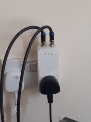

When I say I've one of those connector things at the mains, I mean one of these, I wasn't sure what it was called

@Godfrey haven't seen what looks like power line adapters with f connectors i wouldn't have thought they would send a satellite signal via the electric circuits.

@cookiemonsteruk The photograph is showing a Sky SP161 Power Inserter, which would be supplying power to a Unitron dCSS-422 Sky Q Plug-In adaptor when local mains power within a communal central distribution cabinet is not available.

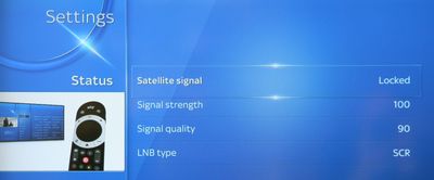

That may be why sky tech told me my power was 67% but seems enough to run my sky q but was told i probably wouldn't be able to run my freesat enabled tv alongside ???
Details as per install
Power (i assume to lnb) 67%
Signal strength 70%
Signal quality 90%
What would i need if at some stage i wanted to run a usals enabled freesat tv and sky q together
