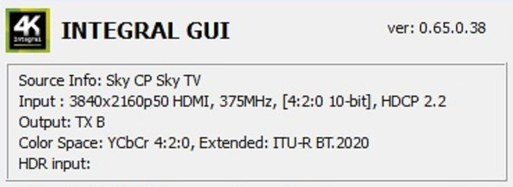

All I can say is that non HLG Programming was not watchable, but HLG was. Not sure always need to see Bt2020, will check out some of my other hdr sources.
again not saying perfect and for me already had the fury so bit of an experiment. Real cost my time!
are v2 box owners seeing bt2020?

@Lp12man wrote:are v2 box owners seeing bt2020?
YES. As I posted previously, This is from a v2 box.

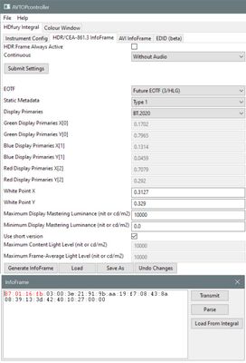

@Lp12man wrote:Now to get compatibility linker is using tv for edid will have a play to see if I can force tv into bt2020.
Even if you force the TV into BT.2020, if the original source material is BT.709 the colours will be wrong. But if you want to try, the Infoframe you need to send is:
87:01:16:fb:03:00:3e:21:91:9b:aa:19:f7:08:43:8a:08:39:13:3d:42:40:10:27:00:00
Or use something like AVTOPCONTROLLER to generate it automatically on your HDFury.
