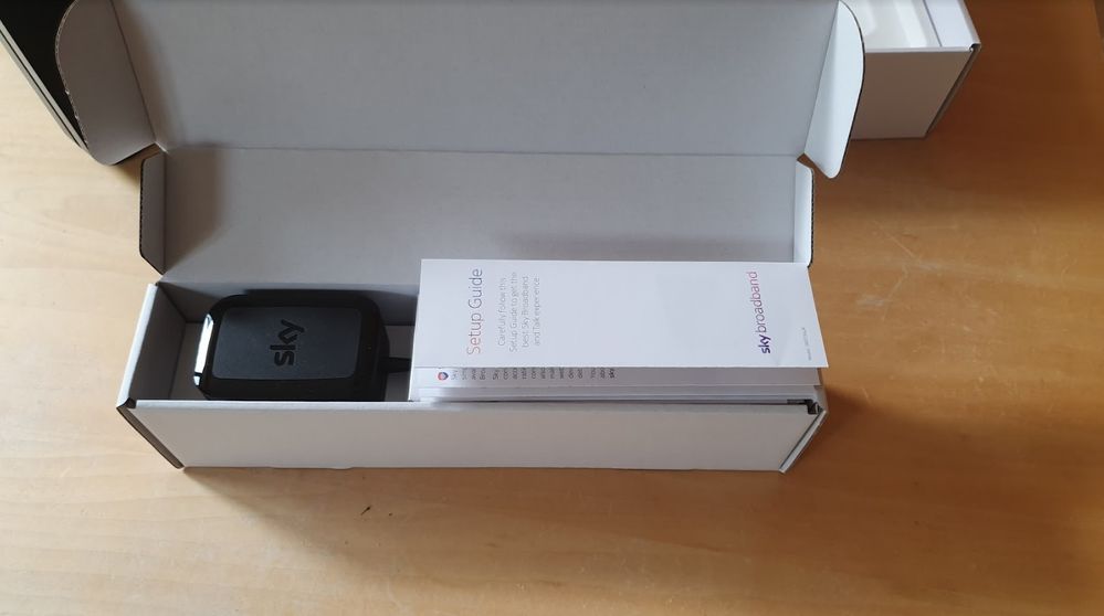

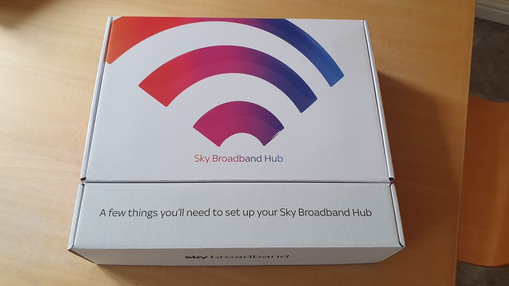

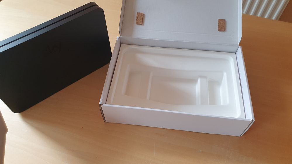

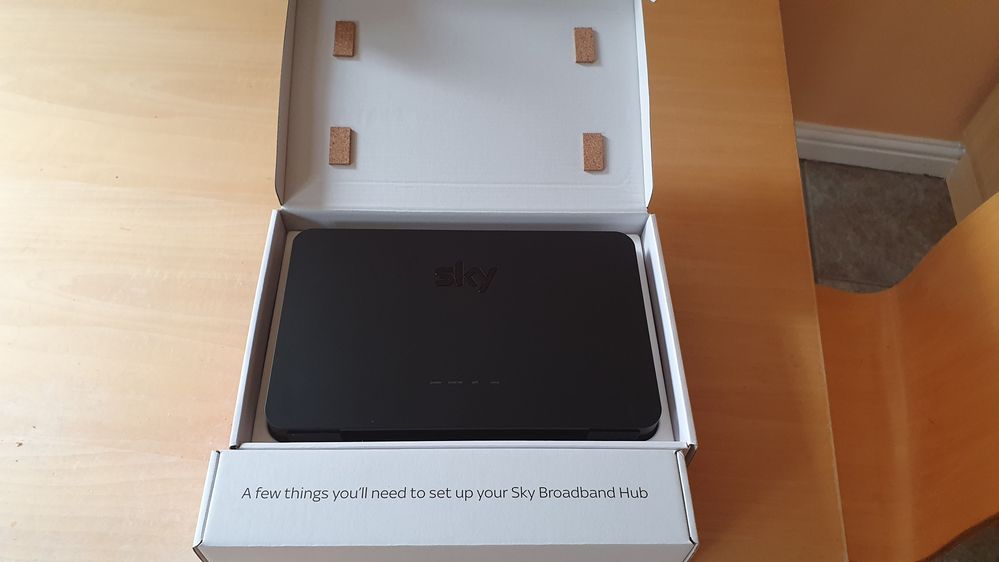

Immediately you notice that the packaging is a lot larger than the old Hub 3 so it certainly will not fit through a letterbox which I don’t think is the end of the world to be honest. Upon opening the box you’ll find two separate boxes, one containing the hub and the other containing power lead, ADSL lead and VOIP lead. The hub 4 noticeably doesn’t come with a microfilter as I assume the hub is aimed at customers who may be using it for FTTP & VOIP.
No sign of plastic packaging whatsoever and it seems all the cardboard is fully recyclable which is a great plus
I forgot to grab a picture of the rear of the hub, i'll add this to the thread later but for those who are wondering it has 4 x ethernet ports as well as the standard RJ11 connector and a telephone connection which I can only assume is there in preparation for a possible Sky VOIP service.
The setup guide included is fairly basic but that is all it needs to be as setting up the hub is very easy. Once turning the power on the hub was ready for me to use in under 10mins which is excellent considering some routers on the market take a good 30mins-1hr to update firmware and then setup.
