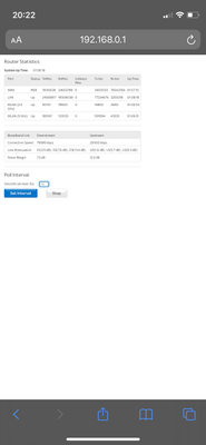

@Loulabelle86 Great but we need to see your router stats, if you won't post them the forum can't help any further.

You have three community members who are highly proficient in diagnosing issues with the broadband line but they do need the information requested, and a post has been provided to assist you in posting the required information, eg: the router stats.

My apologies, as I stated before I'm not technically minded so I've been getting the stats using a link on this page, it takes me a little longer than some people.

Message posted on 11 Aug 2021 08:36 PM
							Re: My broadband has been going on and off for about a week, but when i do a sky connection test it
At the time you posted the stats 76Mbps was already been downloaded re rx b/s. So that would only leave 3Mbps
Message posted on 11 Aug 2021 08:39 PM
Just to add what @cookiemonsteruk has stated the router stats look good and you are almost on top of the cabinet you're connected to at about 70-80 metres or less, eg: there is no fault on the broadband line and the speeds you are achieving over a wired LAN connection is excellent. The router stats do show that the router was rebooted just over an hour ago? Was that you who rebooted (power cycled) the router at that time?
@Loulabelle86 The stats indicate that you have a perfect line, delivering the absolute maximum speeds you can get with your type of connection. Many, many people would snap your arm off to have such a good line.
As @cookiemonsteruk indicates, something is using about 95% of the connections capacity, which would lead to slow speeds on other devices. Do you have anyone doing any heavy downloading at all, especially if their device is using WiFi it won't take much to saturate it.

Ok thanks for the info, my teenage son has just told me one of his games has been updating so maybe that?

I have reset it and reconnected, it never worked, but now my sons game has stopped updating, everything works fine!
Hopefully next time he will let me know that he is the cause!
