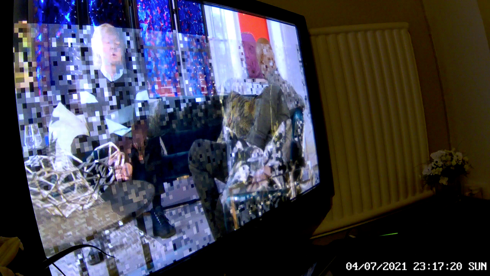

Sky did tout Q160 as a fix for pixellation glitches on both live programmes and recordings. What it has done is make my pixellation issues bigger (full screen instead of the previous narrow horizontal band of distortion) and maybe a little less frequent (2-3 per night instead of 2-3 per hour).
Example below is from BBC1's Paul McCartney interview late last night which I watched live.
Oh dear
If you rewind, does the pixellation repeat too?

No, it's never there on rewind (whether live or recorded). If you are wondering how I filmed it, I now have a CCTV camera recording the TV screen whenever it is on.
Also, I don't think the pixellation affects the UHD box and attached 4K TV, although it hasn't been possible to test it since Q160 arrived. All my glitches are in 2K when watching either of my Mini feeds.

Sky engineer (my third) now booked for Thursday. Having tested/checked/replaced almost everything the last time and found nothing wrong, they might anyway replace my satellite cable which is 20 years old. If that doesn't work, they'll replace my Minis. And if that doesn't work, I'll jump off a bridge.
FWIW, a couple of Youtube links to recent pixellation events which at least I will be able to show to the engineer:
https://youtu.be/SlqWJSRZr6I
https://youtu.be/3ocN1Aqv5Ao
