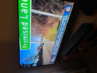

just added NBCNews on sky. Still as a added channel, not on the guide.
